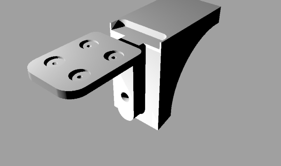

PostPosted: Thu Feb 02, 2006 8:01 am
This is what I'm talking about.
As per everything else I do, it's probably overkill.

PostPosted: Thu Feb 02, 2006 8:09 am
Good picture Paul, That is what I was trying to describe as well.

Paul, I think there is an easier way to make this work with your "tenon jig" if (not withstanding Sylvan and John M's comments) you still want to have the fretboard extension joined to your neck.
Cut the tenon as you would normally on your jig, then route away only a portion of your tenon (and not into your neck as your diagram shows).
